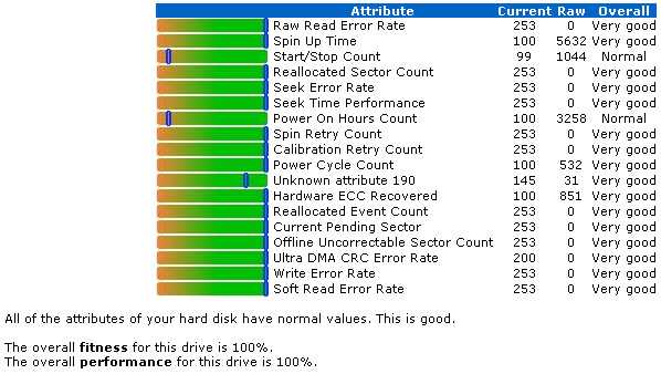

S.M.A.R.T.-Test Eurer HDs
  • WD 60GB, 6-7Jahre alt
    Your hard disk is a WDC WD600BB-00CAA1 with firmware 17.07W17.
    Your hard disk is not reporting its temperature. This is normal for this hard disk model.
    The overall fitness for this drive is 99%.
    The overall performance for this drive is 99%.
    Samsung 160GB, 4 Jahre alt
    NOTE: not all warnings are reflected on fitness and performance overall values as relevancy is based upon the settings from the hard disk manufacturer who is the best entity deputed to define such relationships.
    NOTE : your hard disk Power On Hours Count attribute current value (97) is below the normal range (98 - 100) reported for your specific hard disk model. Basically your hard disk was powered on for more than the maximum time the average user did. This means that either all of the reports collected are from hard disks that were not powered on for too long (this is realistic for recent models) or that your hard disk is becoming old. Usually this is not considered as a pre-failure advisory, but you should check whether you want to replace the hardware or keep an eye on its performances over time.
    The overall fitness for this drive is 97%.
    The overall performance for this drive is 97%.

  • Meine 160GB Hitachi HDS722516VLSA80:
    The overall fitness for this drive is 92%.
    The overall performance for this drive is 92%.

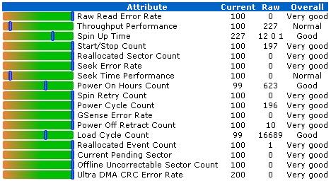

    Die SATA Disk geht nicht, auf dem Server schau ich noch, da hats ne ganze Armada an Disks, wobei wohl längst nicht alle analysiert werden können.
  • Your hard disk is a Hitachi HTS541080G9SA00 with firmware MB4OC60R.
    The average temperature for this hard disk is 40C (MIN=28C MAX=47C) and yours is 49C.
    The overall fitness for this drive is 96%.
    The overall performance for this drive is 90%.
    Und zwar bei einer 1/4 Jahr alten S-ATA HD, 2.5"
  • Your hard disk is a WDC WD2500JS-40MVB1 with firmware 10.02E01. The average temperature for this hard disk is 44C (MIN=27C MAX=60C) and yours is 39C.
    Your hard disk is a WDC WD2500KS-00MJB0 with firmware 02.01C03. The average temperature for this hard disk is 48C (MIN=29C MAX=66C) and yours is 62C.

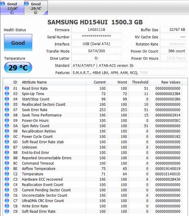

  • *Ausgrab*
    Ich habe mal mit smartmontools via USB meine Samsung HD154Ui getestet, da mein Lian Li EX-50 angefangen hat zu piepsen.
    Sehr viele Werte auf Old Age, d.h. normale Alterung.
    Jedoch folgende sind auf Pre-fail:
    Raw Read Error Rate
    Reallocated Error Count
    Seek Error Rate
    End To End Error
    Und noch folgende (vermutlich irrelevante):
    Spin Up Time
    Seek Time Performance
    Spin Retry Count
    Bei meiner Notebook-Festplatte sieht es folgendermassen aus:
    Raw Read Error Rate
    Spin Up Time
    Auf Pre Fail und der Rest auf Old Age. Festplatte ist ca. 1 Jahr alt.
    Soll ich die Samsung auswechseln lassen?
    Kann die Werte leider nur via Smartmontools testen. HD Tune funktioniert nicht via USB.
    Anmerkung:
    CrystalDisk Info zeigt jedoch andere Werte an...
  • Ob die Werte old-age oder pre-fail sind bestimmt nur was sie beschreiben, nicht den Wert davon. Wenn ein Wert auf pre-fail ist heisst das nur, dass wenn dieser zu hoch ist er auf einen baldigen Ausfall hinweist, er ist jedoch auch ein pre-fail Wert wenn er im normalen Bereich ist. Verstanden? :gap
  • Sehr gut.
    Nun muss ich nur noch herausfinden, wieso dann die HD plötzlich im EX-50 streikt.
    Die lief da vorher problemlos
    Jetzt kriege ich nur noch ein Gepiepse, obwohl der Alarm des Gehäuses abgeschalten ist.
